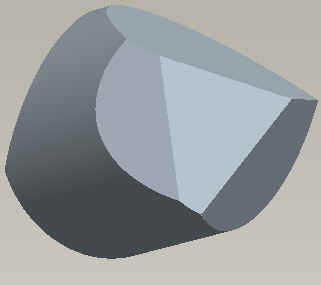

Hello,
I have a solid intersection with another solid in PART mode .
How can I  display only the common area ,without showing the geometry of the non-intersected area.
    |  | A |  |
I.e how can I dispay only  ' A '
Thank you .

... i mean it is not possible to have two solids in one part. maybe you have two konstruction-elements (called features - for example two profiles) in one part but this means that you have one solid. otherwise you have the assembly-mode including two solid-parts - than you have a real intersection...
... would you plaese explain

if you have both parts in an assembly, just create a new part in the assembly and use the option "intersect". The newly created part contains the intersection geometry only.

... for getting an intersection of two kolliding parts in assembly-mode: craeting a new part with menue-manager component-create and in window you have to click part and option intersection. choosing the two parts and the result ist an intersection-part...

Hello,
this is not in the normal functionality of ProE.
But you can do a substition:
-You have a assembly with part1 and part2
-Copy for example part1 to part1copy
-Assemble part1copy in the assembly
-cut out part1 & part2 from part1copy with #Component#AdvUtils#CutOut
negativ is, you loose the parametry of part1.
I hope i could help

Hello,
try to copy the Surface in a third part with Surface/copy/körperfläche(surface of body/part?).
Intersect/join the 2 surfaces from the solid. It may work.

Hi sandor,
what ehlers he means is to create another empty part and then copy the solid-surfaces of the two solids into the new part using the surface/ new/ copy/ solid surfs feature. Once you copied both surfaces you can then use Surface/ Merge to intersect those two surfaces. The new surface you created by merging can then be filled with volume using the create/ protrusion/ use quilt feature.
It will not neccessarily be easy to merge the two surfaces without any gaps though. If there are any gaps the volume fill won´t work.
The far easiest way is as described earlier using the "intersection" option when creating a new part. This works with as many parts as you wish.
You do need the extended assembly license though.
