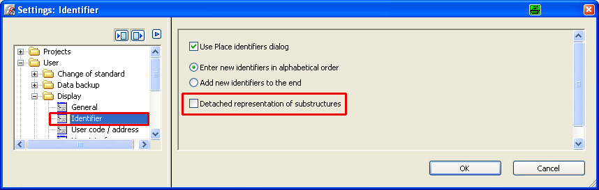

In eplan p8 help file,(EPLAN help\Managing Pages\Page Navigator\Page Navigator:Basics\Project Page View)
it said:
"In user settings you define whether main and sub-identifiers are displayed in one level of the tree, or whether the sub-identifiers are displayed at a lower level."
but how I can define this ?
for example:
I want to let the page =FUNCTION.SUB1+LCA/1, =FUNCTION.SUB2+LCA/2, =FUNCTION.SUB3+LCA/3, display at the same lower level of =FUNCTION,
how can I do like this ?

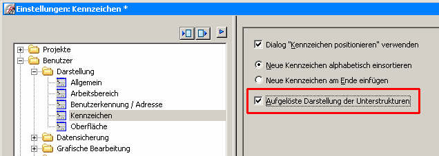

Hi !
This is a user setting.
See example pictures. Hope this is what you're looking for.

Thank you all....
I got it
