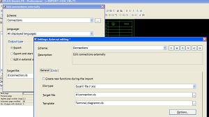

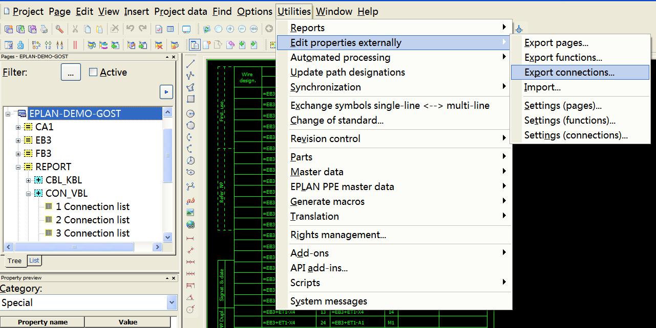

I want to export the terminal data to excel files...
but ..
EditBernd Bild vergrößern zum anklicken...

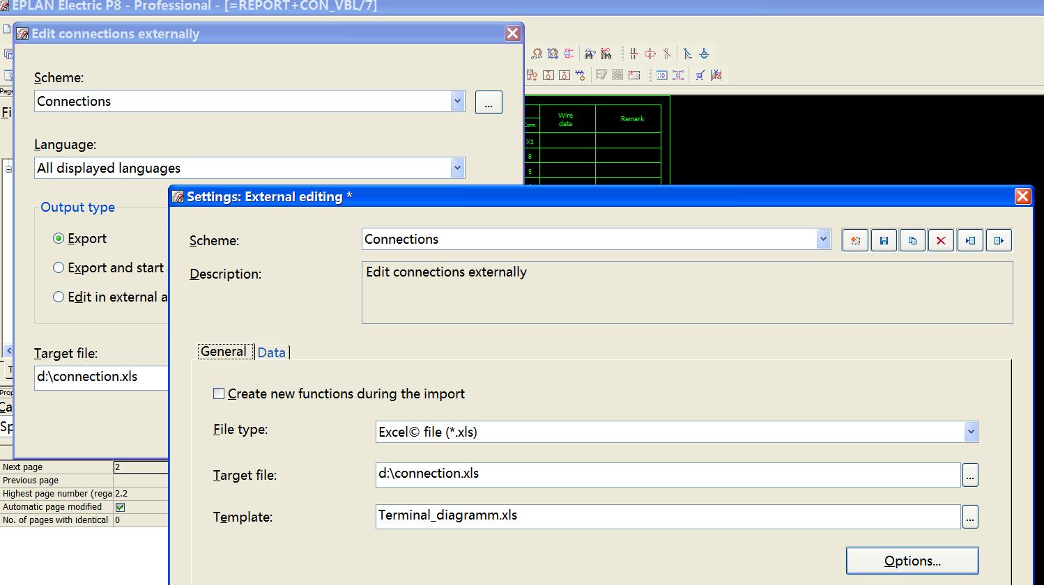

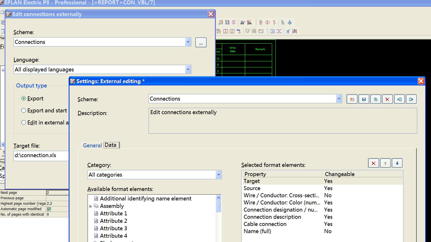

step2:
step3:

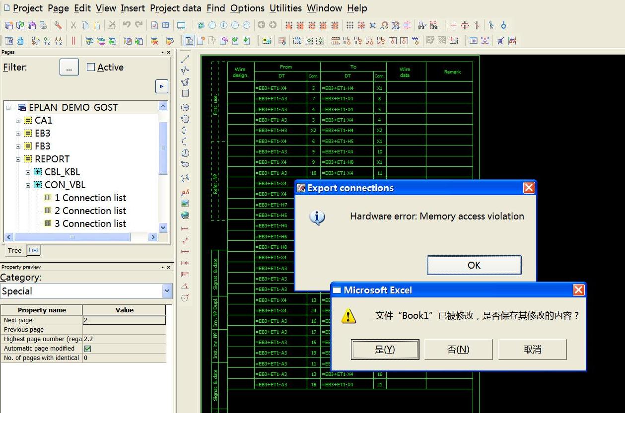

EditBernd Bilder zum vergrößern bitte anklicken...

Looks very cool !
Is the target file d:/connections.xls correkt ?
regards
Horst

thks for your reply...
there is no file connections.xls in disk d:
My physical memory is 2Gb.

Hi !
What means the Excel-MessageBox in English ?
(I'm not able to read chinese  )
And:
Which EPLAN version do You use ?

Hi,nairolf
the means of the Messagebox is
file "book1" has been modified, save the modified data?
if you selected "yes" ,you can save the file book1.xls in your hard disk.
open book1.xls, it looks like the file Terminal_diagramm.xls.
but the data is blank.
the version of my P8 is 1.7.12.1927
thanks for your help...

hi,all
I found if I selected template file Template_EditPropertiesExternal.xls to export. everything is OK.
but I selected Terminal_diagramm.xls, error windows shown.
I don't know the diffrence about the Terminal_diagramm.xls and Template_EditPropertiesExternal.xls.
somebody tell me ?
