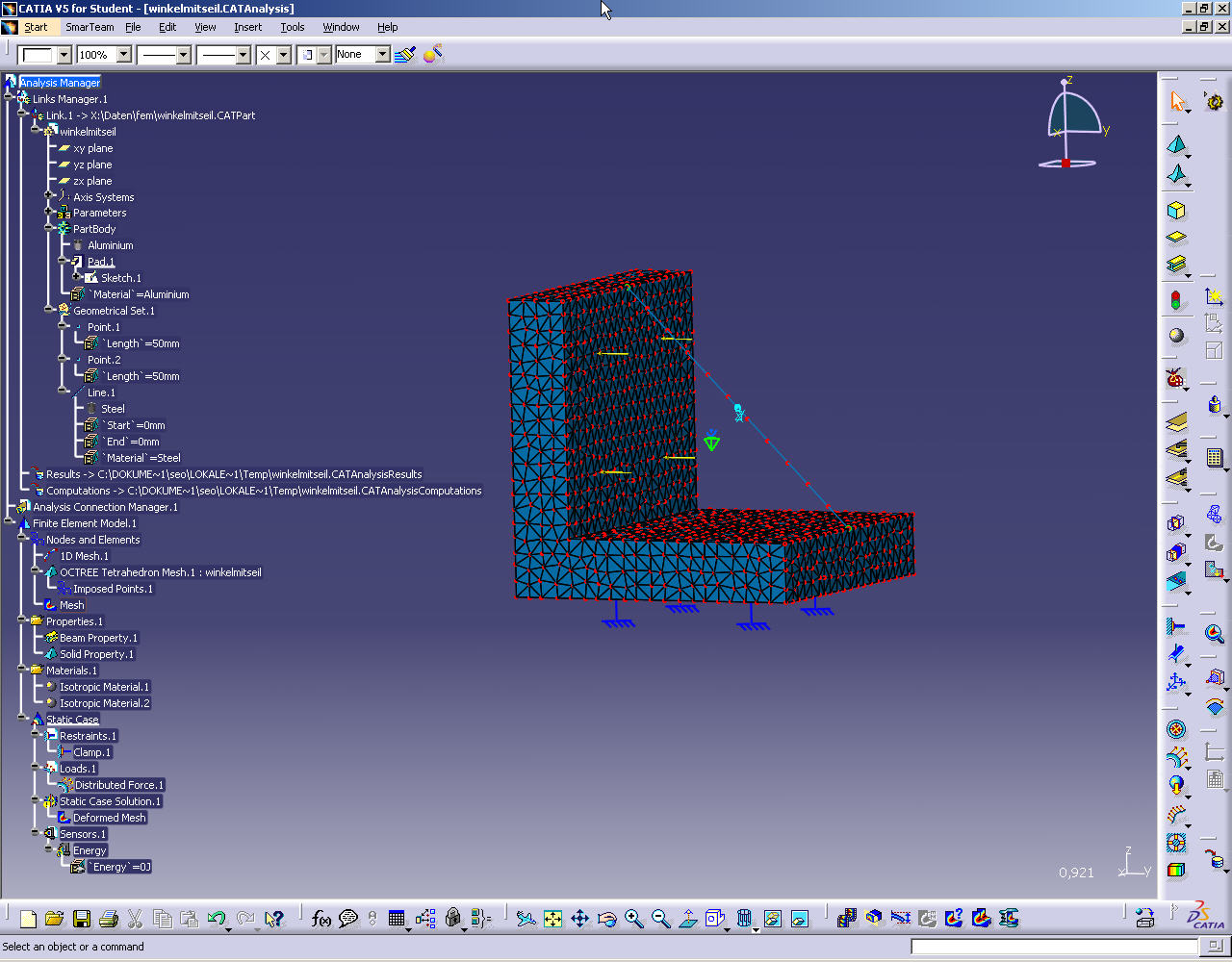

Hallo zusammen
Gibt es eine Möglichkeit 1D- und 3D- Elemente zusammen zu verwenden? Wie  müssen diese allenfalls verbunden werden?

Hallo nochmal
Füge hier mal noch ein Bild eines Beispiels bei, damit ihr euch das besser vorstellen könnt: Es ist ein Winkel, in dem zusätzlich ein Seil gespannt wird. Die Knoten von Seil(1D-Beam-Elemente) liegen auf Knoten der Winkel(3D-Oktaeder-Elemente). Jetzt muss da noch irgend eine Verbindung rein, damit das Seil nicht davon fliegt.

Hello Lorenz
I'm glad to help you. You can post this to the board.
The selection of points is really a bit tricky. It is necessary to be attentive during selecting elements for the first connecting set and for the second. Because there is possible a multiple selection. I also had some problems at the first time.
And also you need a real elements on 3D model (points, lines or faces) to make a connection. Here is a link with a discussion how to separate an area on the 3D model. This can be useful not only for connections but also for boundary conditions and forces. http://ww3.cad.de/foren/ubb/Forum395/HTML/000069.shtml
Surface mesh is also possible way but I think it is more difficult for most applications. And also as I remember this requires Advanced Meshing Tools license.
Regards
Igor
----- Original Message -----
Dear Igor
Thank you for your answer. I tried it in a similiar way first. But wasn't quite sure whether the bodies have to be in different parts or not. Also had problems with selection of end points.
A specialist from IBM Germany has described a different approach to me. He used a Surface Mesh, connected the the beam-elements by automatic mesh capturing and fille the surface with the tetrahedron filler.
Regards, Lorenz
P.S. Is it o.k. if I post parts of this to the board?

Dear Lorenz
There are two possible ways to model your analysis.
The first one by using 1D elements like on your model. But for this you need Generative Assembly Structural Analysis (GAS) license. Using GAS product you should make two General Analysis Connections (please see Analysis Connections chapter in documentation) between end points of 1D element and appropriate elements on the 3D model (line, face or point). But point it is not very good connection for 3D model. Using point connection you will get too high stresses level around it and this is not realistic. It is better to make more realistic connection elements on the 3D model.
When the General Analysis Connections are created you should add Smooth or Rigid connections using Analysis Connections as supports.
The second way don't need a 1D elements at all. You can make a Rigid Spring Virtual Part between two fases on the 3D model. But you need to calculate shtifness of your steel beam element like for spring and add this value as a shtifness for Rigid Spring Virtual Part. Also you need to make a new axis system with X axis along beam element. And use this coordinate system for Rigid Spring Virtual Part.
If you will send me your e-mail adress on igor@3d-point.net I will send you an examples to this case.
Igor

Ich hab das selbe Problem: ein Rohr geht in eine Lasche über, das Rohr will ich mit Schalenelementen, die Lasche mit Tetraederelementen vernetzten und weiß nicht, wie ich das anstellen soll. Aus der obigen Erklärung werd ich nicht schlau.
In einem Buch habe ich dazu eine Lösung gefunden:
http://books.google.de/books?id=WtsrgovDSSIC&pg=PA251&lpg=PA251&dq=Mesh+the+part+catia&source=bl&ots=_20iqO00hP&sig=6B7NRN30b_E4q6Q5486cW7EFsik&hl=de&ei=hN4bSvjHMs-T_Qb3p_ncDA&sa=X  &oi=book_result&ct=result&resnum=1#PPP1,M1
Auf Seite 347 ist das Problem angesprochen. Leider konnte ich das Icon "Add/Remove Constraints" nirgends finden, auch im Internet nicht. Auf der Seite 348, die leider in dem Link nicht abgebildet ist, kommt noch das Icon "Mesh the Part" vor; auf Seite 251 ist es unten auch in dem Link abgebildet. Auch das kann ich niregnds finden. Kann mir jemand helfen?

Hallo GEOP,
die Funktion "Add/Remove Constraints" findest du in der Umgebung "Advanced Meshing Tools" unter "Advanced Surface Mesher" in der Toolbar "Local Specifications".

Hallo dizubi!
Danke für die Antwort
Ich finds trotzdem nicht. Kann es sein, dass das irgendwie mit der (evtl. nicht passenden) Lizenz zu tun hat.
Ich habe die Umgebung "Advanced Meshing Tools" zur Verfügung aber ich finde weder "Advanced Surface Mesher" noch die Toolbar "Local Specifications" noch "Add/Remove Constraints".
Bin ich zu blöd, ist es versteckt, gibt es einen Trick, wie man es finden? Oder kann es tatsächlich sein, dass es es in meiner Version einfach nicht gibt?

Hallo Geop,
du muss in der Umgebung "Advanced Meshing Tools" zunächst den Surface Mesher starten. Danach kommst du automatisch in der Surface Mesher Umgebung und dort findest du die Toolbar geometrical specification in der du deine suchende Funktion finden wirst.
