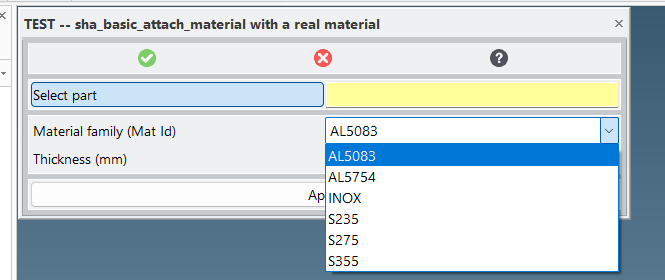

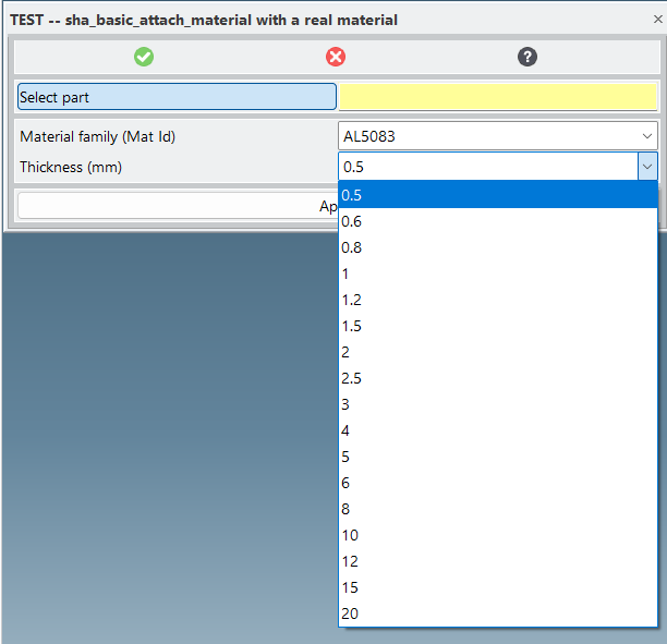

We have many materials defined in Creo . We built a custom dialog to pick family and thickness before applying them to a part (screenshots 1 and 2: the cascading dropdowns with our real data), based on the sheet_part_select.lsp script from this same forum (thread "Blech Material / Blechstärke zuweisen": https://ww3.cad.de/foren/ubb/Forum29/HTML/004924.shtml, with the oli:: package fix mentioned there).
Thickness is applied correctly and persists.
But material is not: whatever value we pass to :material (a literal string or a real code from our own database), the part — and the whole session's material list for new parts — always falls back to a generic default, until Creo is restarted.
Code attached (the block that doesn't work as expected is marked). Any idea what's wrong, or what the correct syntax should be?
We don't have much experience with Lisp in Creo, so any pointer, however basic, is appreciated.
Thanks!

First of all: welcome on CAD.DE Miquel
When reading your post I thought somehow the UI of your dialog does not do what you expect and is loosing, e.g. it's ranges.
But based on the part of the code you marked (!!! great idea and thanks for that !!!) it looks the dialog's UI is fine, but attaching the material is somehow failing.
Basically you are using 'oli::sha_basic_attach_material' .   How to know the correct syntax?
Pointer1: use the online reference.  Start Modeling and your Modules. Type into the Modeling command line:

(oli::sha_basic_attach_material :sheet_part (oli:sd-inq-curr-part) :yes
  :material "AL083" :yes :thickness 2.5 :yes)
I am quite in doubt about all the :YES in your code.  They are normally for confirmations popping up.
Remove those one by one.
The material does not have a check at all (and therefore no confirmation). I would shoot on that one.
Code:
  :material "AL083" :thickness 2.5 :yes)

Original erstellt von mike100X:
That's the part I hardly understand.  "the whole session's material list for new parts"
Sorry I don't get it . Explain! Please use six short clear sentences instead of one long one.
Where it the list, what kind of default, how does it look like?
BTW: if, for understanding the problem the logical table's content is needed. Create a small one with just 3 hardcoded lines inside. A display-table is not needed at all (for that).
