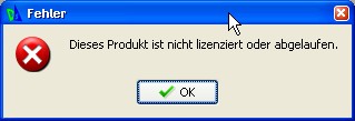

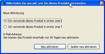

was soll man davon halten? Man bestätigt es... und Programm teilt Dir mit...
Immer diese halbfertige Sachen!

Hallo Thomas
willkommen im Klub
Wenn es ein Trost für Dich ist, Du bist nicht alleine
PS
hab von Dassault folgende Antwort bekommen
(hab das aber nicht weiter verfolgt, weil ich mittlerweile das Handtuch geworfen haben)
Hello,
The Request "30 days trail expired-Activation" has been processed by Dassault Systemes Support Team. Answer is the following one:
Thank you for contacting Dassault Systems DraftSight Technical Support.
When you activate the DraftSight Copy providing your E-mail address, a request is created in our servers that will generate automatically an E-mail containing a link, and that you should receive in the E-mail address you provided. This E-mail contains a link, that you should click, and only after doing it your DraftSight Copy will be activated.
According to the information provided by you, it seems that the registration process is not completed.
We suggest you to please try activating again by specifying some other email-address (may be a new e-mail-address). Also, to complete the Activation Process, make sure that you click the link received in the E-mail address provided by you.
Additionally, to help you with the Activation Process, and with any problem you come across, please visit the DraftSight Community, and go through the Blog Post "Installation and Activation Guide" (https://swym.3ds.com/#post:1291). At the end of the Post you will find a PDF file called "Activation_Guide_V04" that describes the Activation Process.
Hope this helps!
Regards,
Ravi Ranglani
DraftSight Technical Support Team
Dassault Systems | www.3ds.com
Please reply to this email to send us a more detailed scenario and more information related to your hardware/OS configuration.
Kind Regards,
Dassault Systèmes Technical Support

ich hab es bisher noch nicht versucht, aber ich glaube nicht, dass Dassault da irgendein Interesse dran haben könnte diesen Aktivierungsvorgang so einfach wie möglich zu machen. Das es dagerade am Anfang hapert kennen wir doch von der Aktivierungsgeschichte in SolidWorks zur Genüge, was war das am Anfang für ein Drama und mittlerweile trau ich mich sogar im laufenden Betrieb einen Lizenzserver zu aktualisieren bzw. neu zu aktivieren.
Die Freischaltung über eine angeforderte Mail, die dann bestätigt werden muss, ist ja verhältnismäßig normal. Was leider dabei auch schon mal öfter passiert: die Mailadresse wurde falsch eingegeben, die Bestätigungsmail landete im SPAM Ordner wahlweise schon auf dem Mailserver des Empfängers oder im Junkmail im lokalen Mailclient. Da würde ich zuerst mal suchen.

erstellt am: 16. Feb. 2011 14:09    Editieren oder löschen Sie diesen Beitrag!  <-- editieren / zitieren -->   Antwort mit Zitat in Fett Antwort mit kursivem Zitat    Unities abgeben: 1 Unity (wenig hilfreich, aber dennoch)2 Unities3 Unities4 Unities5 Unities6 Unities7 Unities8 Unities9 Unities10 Unities Nur für myca 10 Unities + Antwort hilfreich
Hallo Thomas,
die älteren Beta-Versionen von Draftsight scheinen eine begrenzte Lebensdauer zu haben. Das Problem liess sich bei uns nur durch Neuinstallation mit einer aktuelleren Version (V 10.11.601) beheben.
Die Einstellungen/Anpassungen der alten Version bleiben erhalten, und es muss nicht neu aktiviert werden.

erstellt am: 16. Feb. 2011 14:48    Editieren oder löschen Sie diesen Beitrag!  <-- editieren / zitieren -->   Antwort mit Zitat in Fett Antwort mit kursivem Zitat    Unities abgeben: 1 Unity (wenig hilfreich, aber dennoch)2 Unities3 Unities4 Unities5 Unities6 Unities7 Unities8 Unities9 Unities10 Unities Nur für myca 10 Unities + Antwort hilfreich
Vielleicht hatte der Aktivierungsserver auch einen "bad-hair-day" und hat sich für ein paar Stunden eine Aus-zeit gegönnt. (darf durchaus mal vorkommen)
Am selben Tag klappte bei mir die Rückgabe einer Solidworks Lizenz (HomeUse) auch nicht.

erstellt am: 02. Mrz. 2011 20:18    Editieren oder löschen Sie diesen Beitrag!  <-- editieren / zitieren -->   Antwort mit Zitat in Fett Antwort mit kursivem Zitat    Unities abgeben: 1 Unity (wenig hilfreich, aber dennoch)2 Unities3 Unities4 Unities5 Unities6 Unities7 Unities8 Unities9 Unities10 Unities
Hallo Freunde,
nun ist Beta zu Ende...
http://www.3ds.com/products/draftsight/free-cad-software/
Eine Vollversion fürs Volk - und die laüft! (habe einfach draufgepappt).
