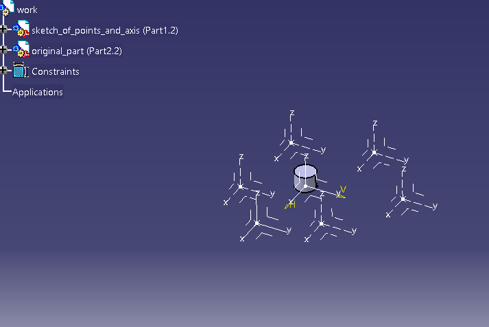

Hey, I working on die design and I have lots of same part and I bored for putting them to axises one by one sometimes 50 or 100 parts.
So I think and found a solution but I'm stuck in code section. What can I do?

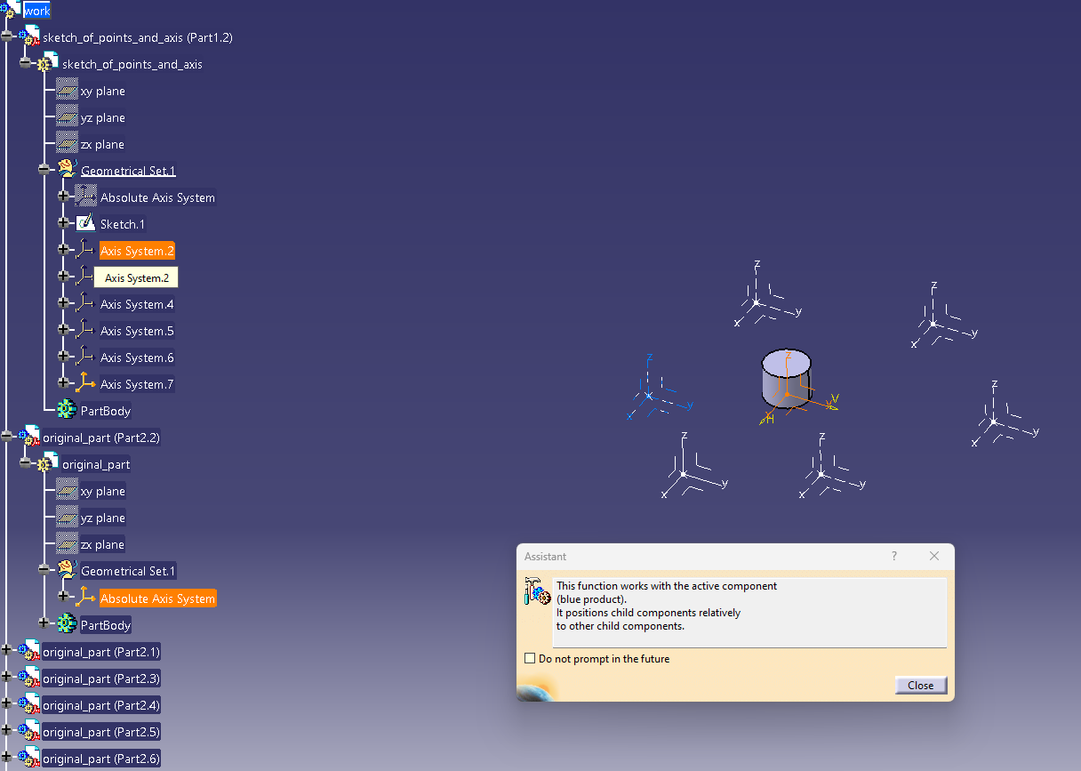

I got error like this my bad:
Compile error: function or interface marked as restricted, or the function uses an Automation type not supported in Visual Basic
If in your free time can you send me example with an assembly? Thank you for everything.

Please have a look on here

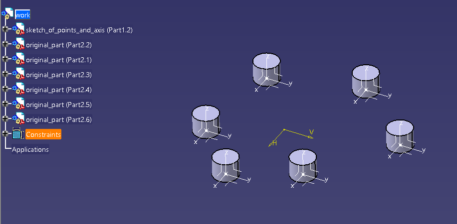

It's worked I tried in catsciprt I need to learn lots of things how can I improve myself in macro can you advice anything? In here I didn't find tutorial or guide for macro or etc because its german  A newbie mistake by me thank you again. Btw is it possible copy of this parts and copies goes other axises?
