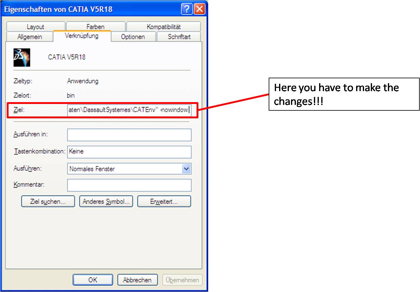

At first you have to make an right-click on the CATIA-Icon on your desktop. Now click on Properties (Screenshot: Admin_1)
Into the destination field (Screenshot: Admin_1) there is a variable called "-direnv". Copy the follwoing path to your explorer.
Into the folder there should be a file called CATIA.V5Rxx.Bxx.txt (depends on your CATIA release)
First make a backup from the file. Then open it with an ascii-editor.
Behind "CATReferenceSettingPath = " there should be no entries.
Now create a new folder (for example in the CATIA installation path). Copy the path of the folder and paste it into the environment file behind "CATReferenceSettingPath = ". This is now the temporary folder of the admin-mode environment.
Following make a copy/paste of the CATIA icon on your Desktop. Rename it for exapmle to "CATIA ADMIN"
open the icons properties -> links -> destination
Afterwards you have to change the line like my exapmle:
Original (should be left on the desktop to work with CATIA):
"C:\Programme\Dassault Systemes\B18\intel_a\code\bin\CATSTART.exe"  -run "CNEXT.exe" -env CATIA.V5R18.B18 -direnv "C:\Dokumente und Einstellungen\All Users\Anwendungsdaten\DassaultSystemes\CATEnv" -nowindow
Changed to start admin-mode (aditinal icon only to make changes in the environment. Not to work with models et cetera)
"C:\Programme\Dassault Systemes\B18\intel_a\code\bin\CATSTART.exe"  -run "CNEXT.exe -admin" -env CATIA.V5R18.B18 -direnv "C:\Dokumente und Einstellungen\All Users\Anwendungsdaten\DassaultSystemes\CATEnv" -nowindow
MFG Daniel
