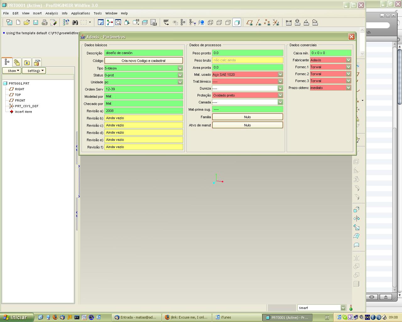

Hi Diego,
Sorry for the delay, it's carnaval here, almost forbidden to work...
Humm, now its time for you to tell us a bit more about your system. This Forum expects to know what hardware you use as well as the version (inclusive datecode) of pro/E you're running. Don´t forget the operating system and the exact version of java you're using.
Generally, java handles unicode (widestring) characters seamlessly, can't remember having seen something like that in java, I think it's more a c or c++ problem, where such conversion take place.
I use windows xp in portuguese and pro/E in english, as there is no version in portuguese. Never had problems with special characters, picture attached (with diseño de camión).
Have you tested the ParamEditor application which comes with the pro/E installation? Same problems here?
If you will, post some of your code here for us to test.

erstellt am: 05. Feb. 2008 13:30    Editieren oder löschen Sie diesen Beitrag!  <-- editieren / zitieren -->   Antwort mit Zitat in Fett Antwort mit kursivem Zitat    Unities abgeben: 1 Unity (wenig hilfreich, aber dennoch)2 Unities3 Unities4 Unities5 Unities6 Unities7 Unities8 Unities9 Unities10 Unities
Ok, I have the application working. The problem was that I have two versions. One Async because I can easily change, compile, and rerun; and the other synchrounous. With the Async version I have always this problem. With the sync now it's working. The problem was that I have in control panel the localization for spain but changed the decimal point (I prefer point instead of comma). I use the spanish localization and it's working in Synchronous mode. Well I don't know why in async do not work (I used jlink_java_command C:\Archivos de programa\Java\jdk1.6.0_02\bin\java.exe -Duser.language=es ... for localizacion problems) but it still do not work. Never mind, the working version is the Synchronous one (it goes 10 times faster).
