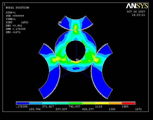

Could somebody change the contact properties (REAL CONSTANTS, KEYOPTIONS, (not MP of solid98!)) of conta175 + targe170 to press through middle cylinder between two others?
Sliding is permited, combin14 - to avoid unconnection instability.
