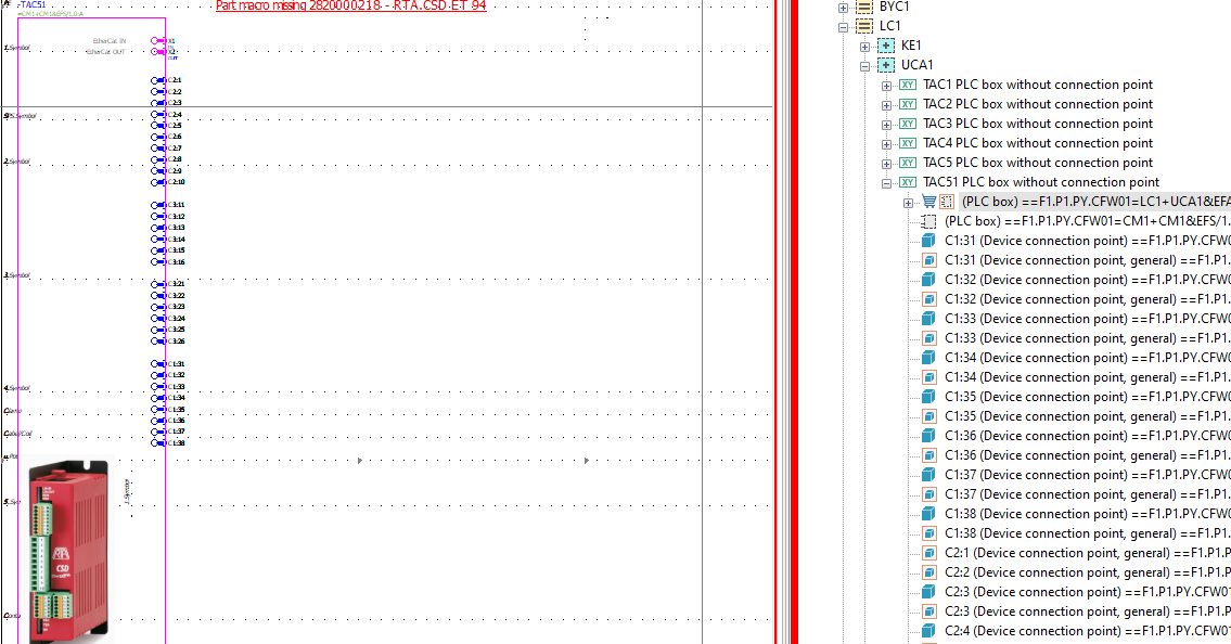

Hallo alles,
Entschuldige fur die Englisch sprache, aber ich kann nicht verstehen alles in deutscher Sprache. Danke im voraus.
Hello everyone,
I have created a PLC box with device connection points indside (not plc connection points, using this for a stepper motor drive) and in the PLC navigator it's not showing me that it is placed within the PLC box (no overlapping). Can someone hint me what did I miss, I placed the connections inside the PLC box and I have the cross reference between the overview and schematic but only for the boxes not for connections. I would really apreciate any kind of response.Thanks in advance.

I will try. You have to use PLC pins to get cross reference with PLC overview. As the name says "PLC overview" can only make them with PLC pins. Try this and it will work. Don´t need to use In- or Outputs.
