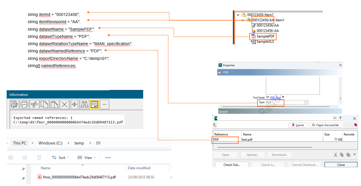

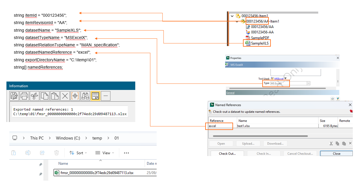

It has been a while since I played with the export.
Above example I made was to export Named reference of the UGMaster ONLY, not standalone dataset under Item revision.
Siemens documentation is not documenting well the parameters to be used in the export function    . In the attached pictures it is explained where to find them.
To the point. Below Code is to export PDF file:
using System;
using NXOpen;
using NXOpen.PDM;
public class NXJournal
public static void Main(string[] args)
Session theSession = NXOpen.Session.GetSession();
ListingWindow theLW = theSession.ListingWindow;
        FileManagement fileMgt = theSession.PdmSession.NewFileManagement();
string itemId = "000123456";
string itemRevisionId = "AA";
string datasetName = "SamplePDF";
string datasetTypeName = "PDF";
string datasetRelationTypeName = "IMAN_specification";
string datasetNamedReference = "PDF";
string exportDirectoryName = "C:\\temp\\01";
                string[] namedReferences;
fileMgt.ExportNamedReferences(
            itemId, itemRevisionId, datasetName, datasetTypeName, datasetRelationTypeName,
datasetNamedReference, exportDirectoryName, out namedReferences);
theLW.Open();
theLW.WriteLine("Exported named references: " + namedReferences.Length.ToString());
foreach(string namedReference in namedReferences)
theLW.WriteLine(namedReference);
public static int GetUnloadOption(string dummy) { return (int)NXOpen.Session.LibraryUnloadOption.Immediately; }
For XLS Spreadsheet use these as function input:
string datasetName = "SampleXLS";
string datasetTypeName = "MSExcelX";
string datasetNamedReference = "excel";
Few notes:
exportDirectoryName has to exist otherwise file will not be exported
The file(s) that is(are) exported has TC name not the named reference name like in the attached examples test1.xls
