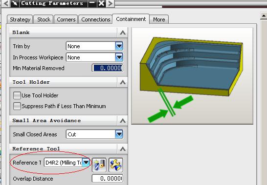

Hallo alle!
Ich möchte eine restmill Betrieb. Aber es scheint keine Methode in nxopen, um ein Nachschlagewerk. Jemand helfen?

Sorry, maybe I should write in English.
Hello everyone!
I would like generate a restmill operation. But there seems no method in nxopen to select a reference tool. Anyone help?
Best regards!

Oops, just found the UF Wrappers AskRefCutter/SetRefCutter.
The docs state that UF_OPER_set_ref_cutter is for Cavity and Zlevel only but this information seems to be incorrect.
Guess you'll need to find the Operation and Tool objects and call
UfSession.Oper.SetRefCutter(Operation.Tag, Tool.Tag)
So something like this should work, assuming you have a rest mill operation "REST_MILLING" and a tool "MILL":
Code:
Tool reftool = (Tool) dispPart.CAMSetup.CAMGroupCollection.FindObject("MILL");
Operation oper = (Operation) dispPart.CAMSetup.CAMOperationCollection.FindObject("REST_MILLING");
theUfSession.Oper.SetRefCutter(oper.Tag, reftool.Tag);

Hello, Overcast!
Thanks you very much for your help! Your code works fine!
