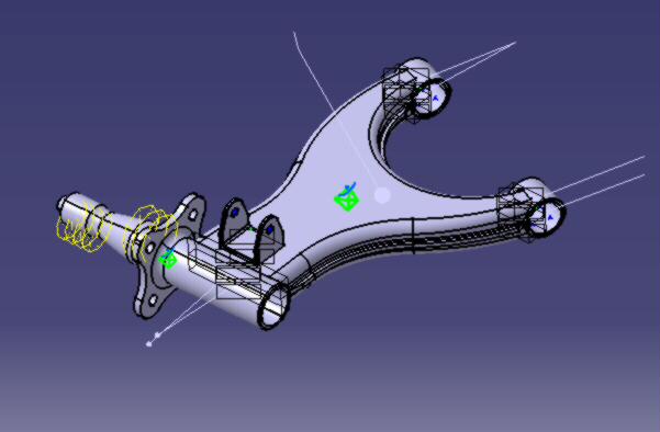

wie muss ich denn diesen Querlenker lagern damit nicht diese Singularitätsmeldung kommt?

It is difficult to understand from the picture all constraints which are applied to the part. But it seems your part is not fixed at least in direction shown in the attached picture.
Please check your constraints. The model as a single body must be constrained from moving along axises X, Y and Z  and from rotation around axises X, Y and Z.
