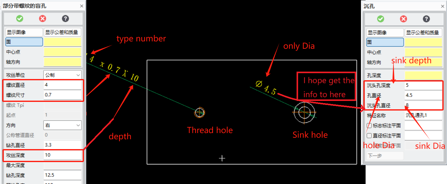

I created two hole features for the solid part within the modeling module.
One is a threaded hole and the other is a sink hole.
[IMG][/IMG]
I can label the thread information in the annotation, but there is no additional information for the sink hole. Is there any way to get the information of the sink hole transferred from the modeling module to the annotation?

Hello my friends, my question is who can do it?

Hello,
which tool did you use to generate the sink hole?
