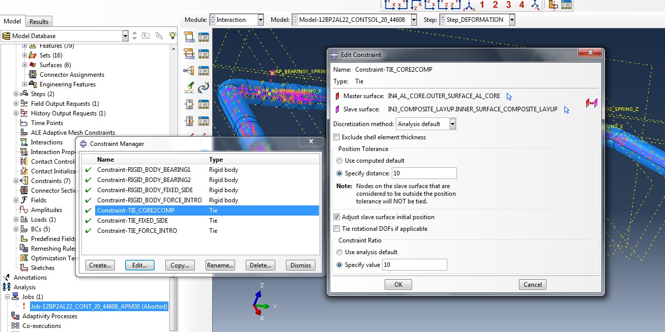

darf ich euch nochmal um Hilfe bitten? Ich bekomme folgende Warnings und Errors (nachfolgend). Habe auch eine Meldung bzgl. inconsistent material orientation bekommen, was ihr im Anhang findet.
Ich simuliere einen Stabilisator, der aus 4 Teilen besteht. Einem Aluminium Kern (=Rohr, C3D8), dessen Mantelfläche mittels TIE Constraint an die Innenfläche des Composite Layup (SC8R) gebunden wird. An den Stirnseiten des Rohres sind ebenfalls mittels TIE jeweils ein Krafteinleitungselement (Stahl, C3D8) angebracht.
Könntet ihr mir bitte helfen, die Fehler auszumerzen? Ich weiß leider echt nicht mehr weiter...

Warnings
If significant clearance/overclosure exists between surface pair (assembly__t0_in3_composite_layup_s,assembly__t0_in3_composite_layup_m) and the master surface does not have rotational degrees of freedom, adjustment is recommended for correct enforcement of the tie constraint
For *tie pair (assembly_in3_composite_layup_inner_surface_composite_layup-assembly_in4_al_core_outer_surface_al_core), not all the nodes that have been adjusted were printed. Specify *preprint,model=yes for complete printout.
For *tie pair (assembly_in3_composite_layup_inner_surface_composite_layup-assembly_in4_al_core_outer_surface_al_core), adjusted nodes with very small adjustments were not printed. Specify *preprint,model=yes for complete printout.
If significant clearance/overclosure exists between surface pair (assembly_surf_head_flange_fixed_side,assembly_surf_comp_layup_flange_fixed_side) and the master surface does not have rotational degrees of freedom, adjustment is recommended for correct enforcement of the tie constraint
If significant clearance/overclosure exists between surface pair (assembly_surf_head_flange_force_intro,assembly_surf_comp_layup_flange_force_intro) and the master surface does not have rotational degrees of freedom, adjustment is recommended for correct enforcement of the tie constraint
The normals for some stacked continuum shell elements deviate by more than 20 degrees. This can lead errors in the output variables ctshr.

Das sind doch nur Warnungen. Derentwegen bleibt die Rechnung nicht stehen. Es müssen noch weitere Errormeldungen vorliegen.
