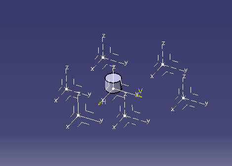

I found product part copy from point but I got stuck from recording of macro.
I used "Add User Companent" command in tg1 licence. Any idea how can I get this code?

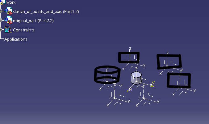

In product you select a part and selecting a sketch which is have points. And this command makes copies of part in product.

Per macro this becomes difficult.
Manually I would proceed like this:
- pattern a 3d line in the part with the sketch
- reuse the pattern in the assembly
