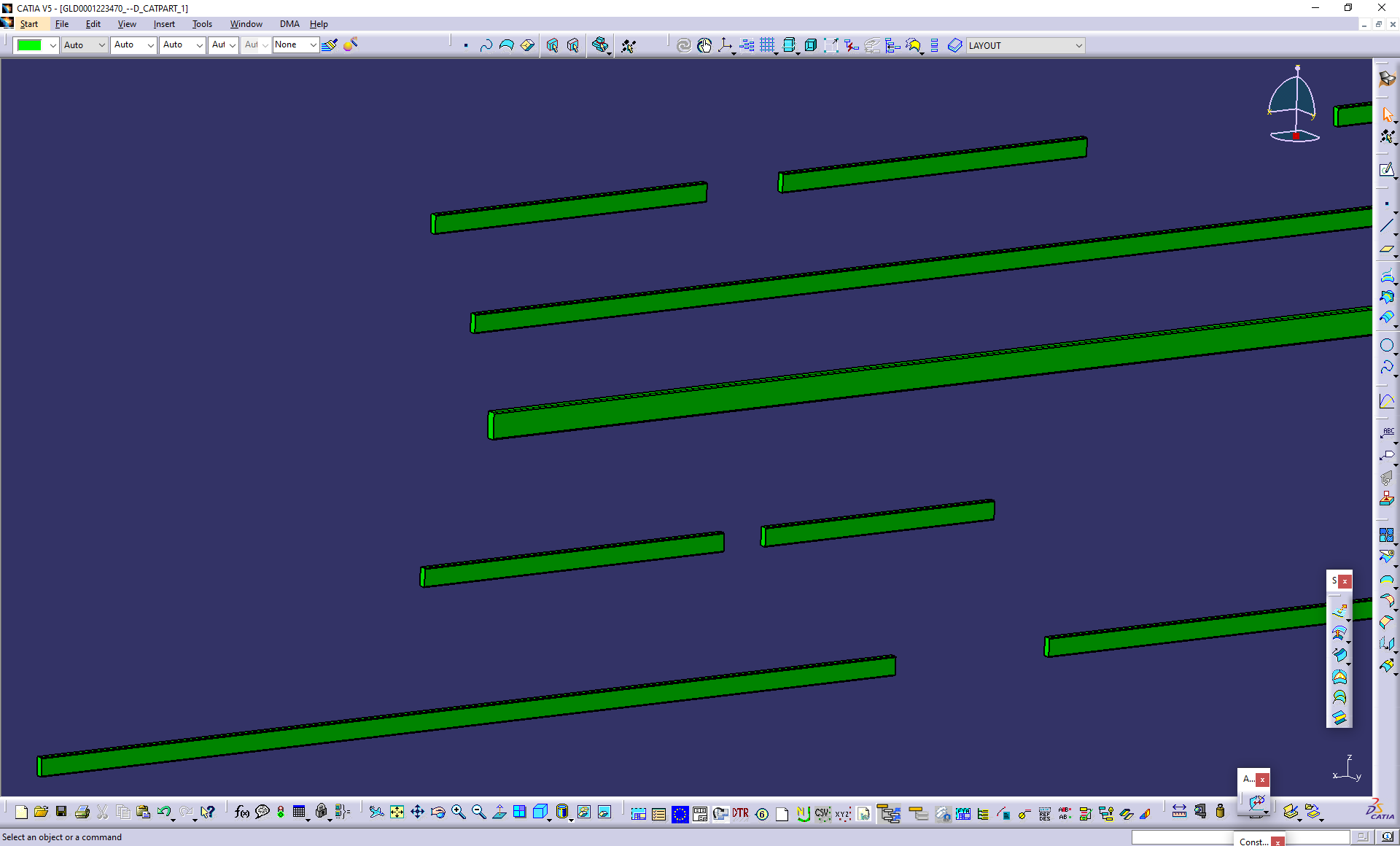

Hello
I was wondering if you have already faced this and have solution ready, or you can point me how to deal with this:
I have multiple bodies from which i need to select only front face and get their area all together. Now i know i can select those faces manually, but there are really a lot. How can manage this faster?

I have one-sketch body sliced many times by remove operation. I need to measure area of surfaces normal ZX plane. There are around 200 faces
