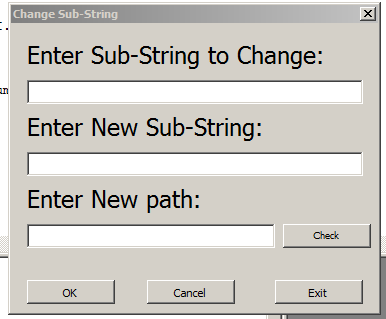

Hi Programmers!
I'm trying to write a VBA macro, which would:
-scan CATIA tree structure,
-change some PartNames or some strings in PartNames with String defined by User in UserForm GUI
-save all tree components with new PartNames + Main product (with change PartNumber too) under path defined by User in    UserForm GUI
VBA project attachted (please start it with Start module).
It seems that I have problem with saving products, because I get the error-code by this line:

Hi Lucas,
since my Polish is not half as good as your English,
I first had to translate the dialog.
Please correct me, if I guessed badly :-)

Hi Joe
Thank you for your analysis! Your comments are really useful, and I'll try to keep to them by this and my next projects.
Your translation was really good! I'm impressed, and parallely sorry for my Polish words in my project
As to your code: There's something wrong with the creation of the folder according to GUI.path.text - it seems, that this variable:
Code:
doc_sznur = GUI.path.Text
takes value of the initial folder, from which Product was opened, with the every iteration of the loop.
In result, it doesn't create new folder, but saves new files under initial folder.
Additionally, when I change name in only one Part or Product, only this particular part is saved within initial folder with new name, and all other parts are gone!
In the end, this macro would be used to change name in the whole assembly, so that's not a problem. BUT if I would like to change only one part - it will delete all non-modified parts in initial folder - and that would be a disaster.....Could you help me with this too?

Hi
Let's clear some things.
The logic is correct, but the second option is still not working for me. I've changed the textbox value  in the GUI, but still the code doesn't create folder for me.
Regarding the GUI buttons:
Cancel - which supposed to be translated as Next -> should reset Sub-strings text boxes and show the GUI again (in case when user wants to have 2 different new sub-strings or wants to change some other sub-string in different Part). It should only rename parts, without any saving operation yet.
OK - should close GUI and run the save & delete section
Exit - cancels macro
Check - supposed to be translated as browse should open folder browser (alternative option instead of manual typing of the new path)

Hi Lucas,
It's not error tolerant. If the dir is not the immediate descendant of an existing one, it probably won't work.
Furthermore: If you enter a folder name with a trailing backslash, it probably won't work.
I thought that 'Cancel' was wrong. It wouldn't make sense.
Which they do.
As of now: Does nothing.
I would prefer this option. No typos, no impossible dirs.
And change the textbox to a label.
About the saving options:
Do you only want to replace changed files?
Or be able to write everything to a new directory?
Or...?
Still guessing here.
Cheers,
Joe

So any and all write-ops have to be to a different dir than the 'Ref Dir'(read dir),
which is - by definition - read only.
Which begs the question: What is the 'File Delete Routine' for?
As for the browse dialog:
Check the two vbscript versions, especially the one by Rajendra Khope
https://msdn.microsoft.com/en-us/library/windows/desktop/bb774065%28v=vs.85%29.aspx
Cheers,
Joe
That's a good point!
Let me think... I thought about possibility, that macro could do some cleanup in the ref dir, when for example PartName <> FileName. That would be extra funcionality of the code
P.S. Still the impact of the name changing of the components in the assembly and saving under new name on the external references links must be checked... I read somewhere, that this would work flawless, when the renaming procedure is run as a CATscript, not as a CATvba prohect. If that is the true, then could you show me how to run CATScript from within VBA?
P.P.S. What if user wants only to synchronise PartNames with InstanceNames within ref Dir - could we implement such possibility in our little project? Let's say: when the both Inputtext fields are empty, then synchronise PartNames with InstanceNames ans save within the project root path
P.P.P.S  when I run the project, I get following message:
Test it. Rename the files. Close the product. Reopen the product. Check the links.
No. Only a different folder. The files are your originals/reference.
Design a strategy first and stick to it!
That error message looks like VB got messed up.
Save. Close catia and reopen again.

Hi
It all works great! Thank you Joe for your help and patience.
Only one glitch bothers me... what will happen when the root or goal path will be very long? Will your UserForm self-adopt to the label length? or should I set the width fix somehow?

Hi Lucas,
look at the ToolTip.
Cheers,
Joe
