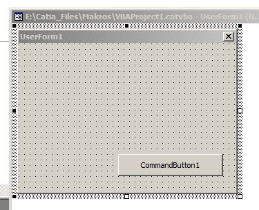

kopier mal den Code in eine leere Userform mit einem CommandButton(Bild anbei):
Code:
Dim chkBx(4) As MSForms.CheckBox 'global
Private Sub CommandButton1_Click()
  Dim n As Integer
  For n = 0 To UBound(chkBx)
      Debug.Print chkBx(n).Value
  Next
'  On Error Resume Next
'  For n = 1 To UserForm1.Controls.Count
'      Debug.Print UserForm1.Controls.Item(n).Caption
'      Debug.Print UserForm1.Controls.Item(n).Name
'  Next
End Sub
Private Sub UserForm_AddControl(ByVal Control As MSForms.Control)
  Debug.Print "in addcontrol"
End Sub
Private Sub UserForm_Initialize()
  Dim n As Integer
  For n = 0 To 4
    Set chkBx(n) = Controls.Add("Forms.CheckBox.1")
    chkBx(n).Left = 5
    chkBx(n).Top = n * chkBx(n).Height + 5
    chkBx(n).Caption = chkBx(n).Name
  Next
  Me.Width = 5 * 80 + 10
End Sub
Vielleicht geht's mit einem Control-Array.
Tschau,
Joe
