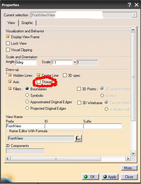

Ich brauche einen Befehl, die Thread-Option aktiviert in View Properties.(siehe Anhang)
Danke im Voraus,
Paul

Hallo Rick and danke für deine schnell Antwort,
So, ich habe eine Makro gemacht, dass eine 2d Zeichnung von eine Product machen.
Set drwViews = drwSheet.Views
Set drwView = drwViews.Add(MyString)
Set drwViewGenerativeLinks = drwView.GenerativeLinks
Set drwViewGenerativeBehavior = drwView.GenerativeBehavior
Set oDoc3 = CATIA.Documents
drwViewGenerativeLinks.AddLink PartBDs.item(iPB)
drwView.GenerativeBehavior.HiddenLineMode = catHLRModeOn
drwViewGenerativeBehavior.DefineFrontView myAxisCoordinate(3),myAxisCoordinate(4),myAxisCoordinate(5),myAxisCoordinate(6),myAxisCoordinate(7),myAxisCoordinate(8)
drwView.x = 100
drwView.y = 200
drwView.Scale = 1
drwViewGenerativeBehavior.Update
drwView.Activate
In GenerativeBehavior habe ich gefindet alle andere options zu ändern aber für Thread Option nicht.
Ich möchte dass in 2d Ansicht sehe ich die Gewinde von alees 3d Bohrungen mit Gewinde.

Oh I am sorry for that. I didn't thought that the language is the problem. Maybe english will be the better choice...
Okay now I know what you want to do. I think the "DrawingViewGenerativeBehavior"-Object is the only one which provides some properties for the "View"-Object that way. As far as I know there are no other objects which provides those kind of properties in the API of CATIA. So maybe the CAA-Environment will afford more possibilities but for that you need special licenses and it is writen in native C.

Thanks Rick,
It is much easier in English, but at least you understood what I wanted to do  .
OK, so there is no command available to activate that Option, but there is no possibility to draw threads with a macro???
Normally we have a 2d command to draw threads but for this we should have all 2d Circle to be selected , and this selection should be done according to the 3D model, only for the Holes with Thread.
I'm a beginner in Programming and this is too complex for me to do by my self, so maybe is somebody who know how to make Threads in 2d View with a macro and will help me with this.

There is a collection of Threads in the View. Each Thread has a property .Type. This property looks good.

I have tried all that I have found in V5 Automation but I wasn't bin able to write the command lines that make Threads to be drawn in the view.
And the code that you have normally change the type of the thread in Threaded or Taped but doesn't generate anything, or I didn't understood exactly how this is working.
I have found also how to create this collection of threads but how I make then to be draw in my View????
Dim MyView As DrawingView
Set MyView = MySheet.Views.ActiveView
Dim MyThread As DrawingThread
Set MyThread = MyView.Threads.Add(iGeomElem)
All that I have tried doesn't do anything in my drawing.

Try this:
Code:
Set oThreads = View.Threads
For each oThread in oThreads
    oThread.Type = catThreaded
next
I think that this wouldn't help you because this property would be read only if the threads are linked to 3D geometry. But maybe it works... I have not tried out yet!

I have tried your code but it doesn't do anything in my drawing. Anyway my view is linked to 3D, all views are made from .catparts.
I was thinking off something.... but I don't know if it is possible.
Can we create a User "Generative View Style" where we select exactly the options for the View creation , and then when we create the view we simply select this Style for the view.
This is theory only. I don't know where I can find, or how can I make this User "Generative View Style" , and if this is done how to insert this style in catia so it can be selectable when I create a View.
And last thing is that maybe I need administrator rights to do this.
or maybe it is possible??
