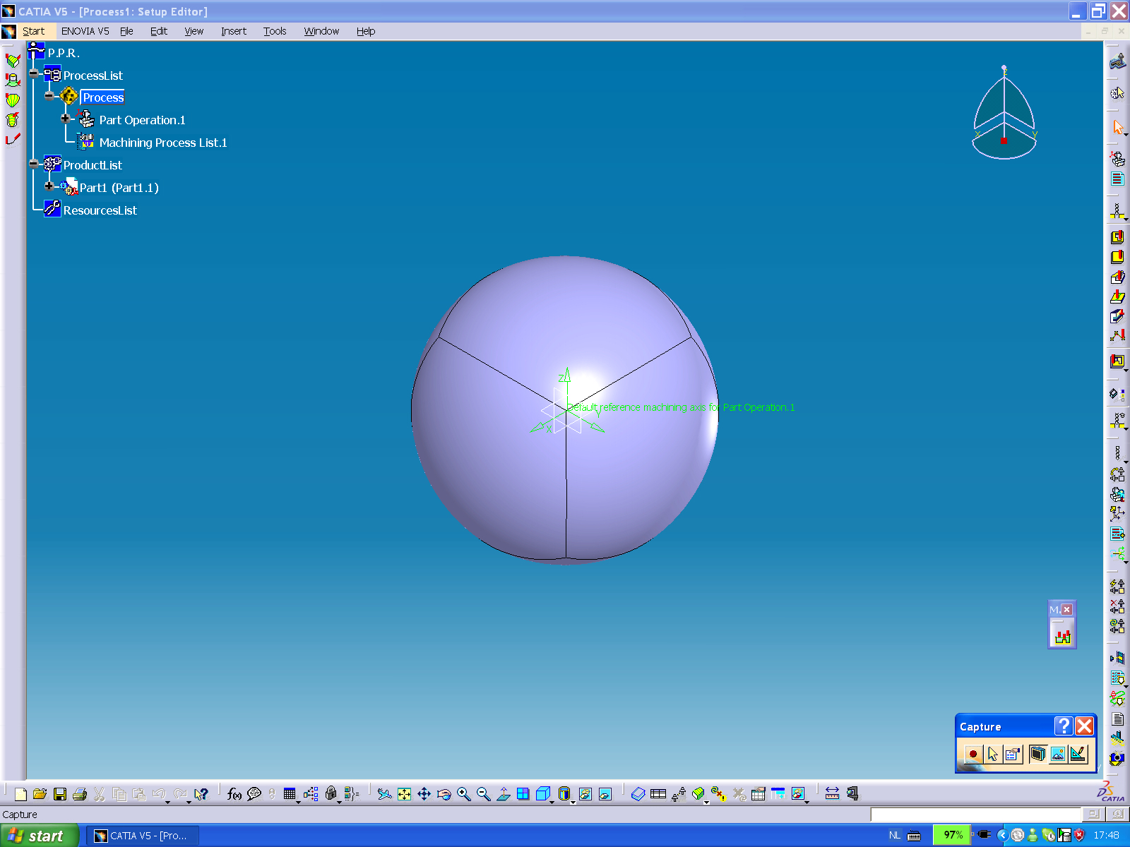

kann jemand mir sagen wie ich eine kugel frasen kann in catia v5 r17
kugel ist 360 rund
es gelingt mir einfach nicht uberhaupt eine teil zu frasen

Frage hierzu: Was genau meinst Du mit Kugel fräsen?
- Willst Du eine komplette Kugel aussen fräsen/unten spannen mitsamt dem Hinterschnitt
- Willst Du nur bis zur Hälfte die Kugel aussen fräsen (ohne den Hinterschnitt
- Willst Du eine Halbkugel innen fräsen (also eine Vertiefung in eine Platte etc.)
Vielleicht kannst Du ja ein Bild Deiner Konstruktion anhängen - ich denke dann wird's gleich klarer...

i want to mill a ball that is grounded to the milling machine  by screw tread in the center
then i want to mill first one side all the way  we stat with a cube
then when i am ready the other side
but i cannot define it in the module
its  seems impossible to do
do you see a way to do this?  ,would be very gratefull

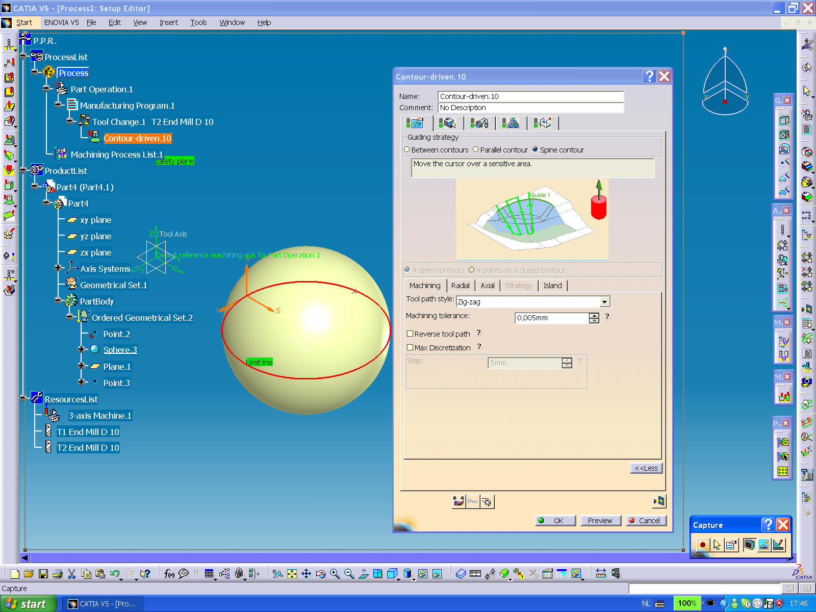

Bild.zip
Hello again!
My English is not very good too - but I think I've understood your problems.
Look at the attachment.
"Bild_1" and "Bild_2" belong together.
"Bild_3" and "Bild_4" belong together.
I hope the pictures looks self-explanatory.
If there are more questions - ask again.
Greetings
Martin

i am really getting grazy
follow me i do the same as you martin
busy with it a day
still got the same error
its says the part is the same as context (in  preview)
and on icon  can not calc part check parameters
what am i doing wrong?
changed axes and all no change,do tons of differant things same error

Bild2.zip
Hello again!
First of all - you have to set your "Part Operation.1".
Look at the pictures...
Greetings Martin
P.S. I think you should read the manuals

again  i did the same as you
but got the same  error
"part to machine and context are indentical
please change one of them"
i really do not know what i do wrong and what i should change
its weird
also cannot find it in  help file
well worked the whole weekend on this ¨problem  cannot figure out waht i am doing wrong meaby you martin?

Bild_3.zip
Hello again!
- I think you have to update the Part.
- I think there's someting wrong in your "Part Operation.1" - but I'm not 100% sure.
- Please attach your Process + Part (zip), then I will give you more help.
Greetings
Martin

hi martin
thanks for all the help ,i think the problem was i klick at the wrong position in the tree
i can now make the program
well i try to get things working on technologie things now,and try go get things machined in parts  when i have a long part
