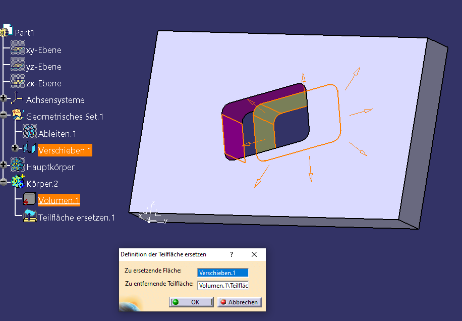

Hello Team
Sometimes (very often lately) I need to adapt / move some holes/cutouts in dead solids quickly. I don't want to do it by editing the "gap" step by step (remove faces+sketch/pocket or hole)...
Does anyone know CATIA License and/or command to move faces inside dead solid with one function? Without step-by-step repairing the solid?
Best regards
Lucas

Hi Lucas
On simple geometry you may try to use Replace Face Feature (e.g. see catiadoc.free.fr/online/prtug_C2/prtugbt0715.htm )

Hi Lucas,
As Bernd already pointed out, this will only work with very simple geometry.
In the example shown here the surface is planar, the cutout got no draft, no fillets, nothing.
My idea would be to repair the solid w/o holes and create new holes and cutouts which then can be controlled and modified as required in CATIA.
If your data is dead because you got it from a supplier via STEP / IGES, it's more recommendable to have the change done by the supplier and have it provide new data to make sure your new resulting data will look as delivered.
So IMHO it also depends on the precise situation, maybe you can share some information about that.
Kind Regards ... Wolfi

Hello
The reason I'm editing my imported STEP file this way is that, those are not significant / important changes, just cosmetic ones  . Supplier STEP file is heavyweight (>1,5 GB) and managing it each time is painful. (import+allcatpart+cleaning up) and the supplier isn't very "responsive" when it comes to communication  so I rater modify it yself and let him know what to change with next release
AFAIK, replace face is also sketch-based, am I right? So at the end I will have to create mid-steps for the operation myself  I used to patch those problems with remove face + "moved" sketch + new pocket. I thought there's faster way then that...
Thanks for comments tho

Original erstellt von Sylas:
(...) AFAIK, replace face is also sketch-based, am I right?  (...)
Well, not really ... You need a replacing face. If this is created via sketch or another dead import, doesn't matter.
It seems there's no better way than fixing all that stuff more or less manually.
Cheers ... Wolfi
