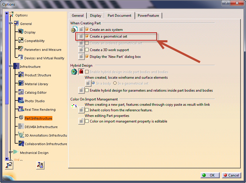

Can i ask about how do i start Catia with a Catpart instead of Catproduct?
Also when i start Catia i want a geometrical set automatically generated.That works fine but it always inserts above the partbody.Is there a way to always have it below the partbody?

erstellt am: 06. Jul. 2012 10:37    Editieren oder löschen Sie diesen Beitrag!  <-- editieren / zitieren -->   Antwort mit Zitat in Fett Antwort mit kursivem Zitat    Unities abgeben: 1 Unity (wenig hilfreich, aber dennoch)2 Unities3 Unities4 Unities5 Unities6 Unities7 Unities8 Unities9 Unities10 Unities Nur für Thewiruz 10 Unities + Antwort hilfreich
I dont comprehend your Problem. In my envorement it works very well.
do you have the Buttom enabled? (show Picture)

erstellt am: 06. Jul. 2012 14:23    Editieren oder löschen Sie diesen Beitrag!  <-- editieren / zitieren -->   Antwort mit Zitat in Fett Antwort mit kursivem Zitat    Unities abgeben: 1 Unity (wenig hilfreich, aber dennoch)2 Unities3 Unities4 Unities5 Unities6 Unities7 Unities8 Unities9 Unities10 Unities
Hello and thanks for your reply!
Yes that check box is enabled! I have made a picture of what i am trying to accomplish, I'm sorry but its a big image and i am not sure how to put a thumbnail with a link to the bigger picture

Hi, Thewiruz.
It is not possible to start Catia with a PartDocument. But if you include the Variable "CATNoStartDocument" and set it to "1" in your Environmentfile, No StartProduct will be given, and you Start with the "clean" Catia-Background.

Hello,
you could develop a marco for that Problem. Write a macro that opens a new Part and insert a geometrical set. Then you have to pass the macro to the catstart.exe.
For example:
Code:
$STARTPATH$\CNEXT.exe -env $ENVNAME$ -direnv $ENVDIR$ -nowindow -macro $FullNameOfMacro (With Path and Extension)$
NOTE: The CNEXT.exe must be called
