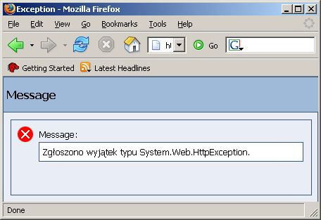

After upgrading to V14 SP5 after initial screen with DB selection I got the error message (see attached file WebEditor-V5R14SP5-Win2000_Server+IIS-error.jpg:
Exception: System.Web.HttpException
My configuration: Windows 2000 Server, IIS, MS SQL 2000, SmDemo database.

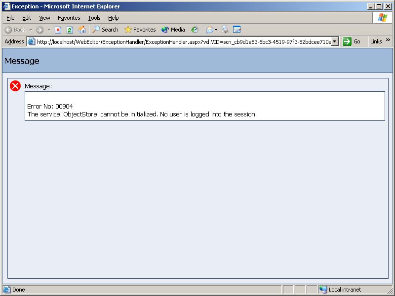

Slightly desperate I've made an experiment: on another computer with "clear" Windows 2003 Server I installed from scratch SmarTeam V5R14 SP1 with pure SmDemo database. After Web Editor configuration the same error occurred (see beginning of this post). After upgrading to V5R14 SP5 I got the error (see attached file: WebEditor-V5R14SP5-Win2003_Server+IIS-error.jpg):
"The service 'ObjectStore' cannot be initialized. No user is logged into the session."

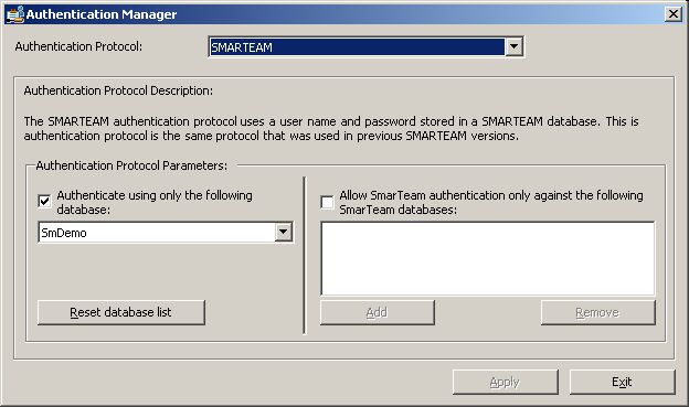

> - Define a database for authentication using the Authentication Manager?

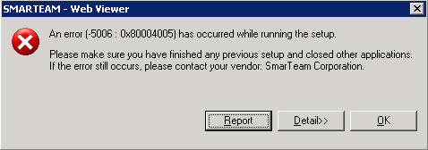

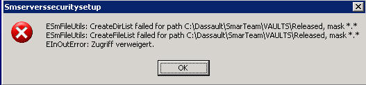

I just got my first steps with the Web Editor yesterday when I´ve installed the applications with the installation guide and everything seems to going on correctly. But there is still something wrong.
Szenario:
- Win2003 Server (FDN, EDR and then WED installed)
- IIS and Terminal Service installed
- Oracle Database, configured for Web Editor
- Licenses available (detected by the diagnostic tool)
- SMARTEAM/Web directory shared for SmarTeam Server Application group
- JRE installed
- System Configuration Editor can be used without problems.
Status Quo:
- All Service started correctly
- the login display appears in the browser, login with "joe"
- After selecting the database "SmTest" the browser tries to open the page "Default.aspx" -> up to 500MB RAM will be used but nothing happens further (see first attachment)
- Installing Service Pack 6 results in an error messages (see 2nd attachment)
A few questions:
- What meens the error messages of the ServicePack?
- Is there anything to configure in the IIS not mentioned in the guide (Security, Root directory (default: c:\inetpub\wwwroot), methods of authentification)?
- Is there anything to configure in the System Configuration Editor manuelly?
- Are there any experiences with domain / local user (still I´m working with a local user and a computer in a domain) ?
- I habe trouble to install the Web Viewer (try: 18000 (SP3). 18004 (SP6) and 18008): I got an error message just after file extraction (See attachment) - perhaps because of the terminal server??
I´m using R14 SP6

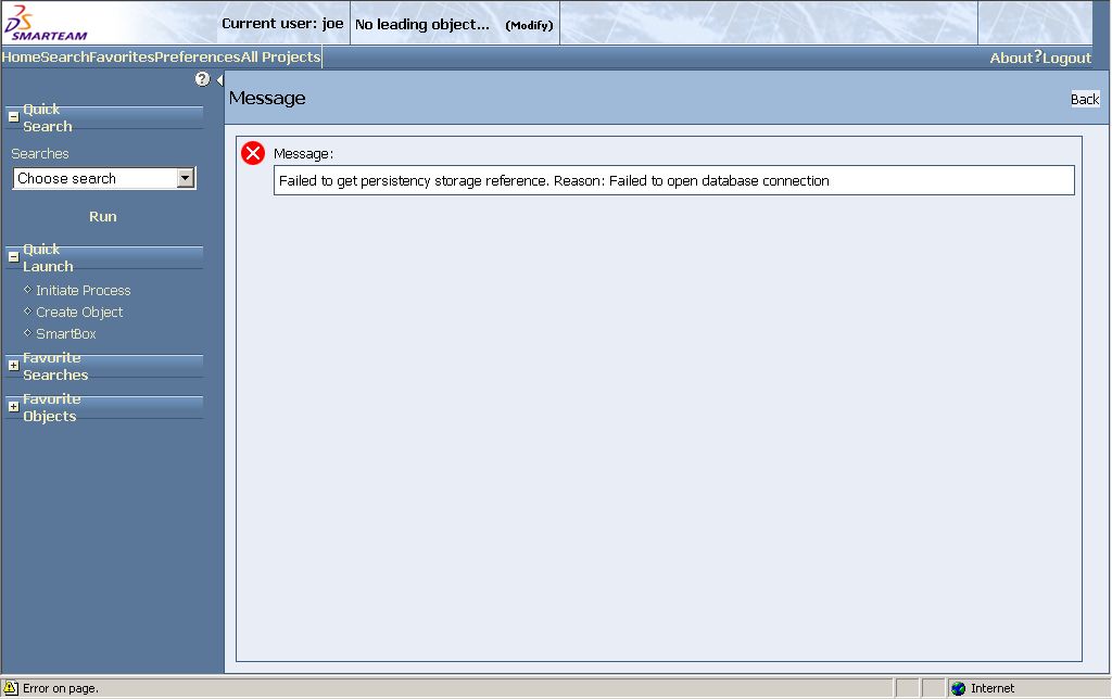

Because the latest Service Pack 7 of V14 is available so I installed it.
I must say the things are getting better. I can log into database! I can see my SmartBox messages via Web Editor (see attachement: ST_V5R14_SP7-start.jpg)! Absolutely amazing!
But any other command (for example displaying the list of the projects) leads to the error (see attachement: ST_V5R14_SP7-error.jpg)
"Failed to get persistency storage reference. Reason: Failed to open database connection"
I hope that they will fix everything in SP 11 :-|
Jack

erstellt am: 09. Aug. 2005 21:57    Editieren oder löschen Sie diesen Beitrag!  <-- editieren / zitieren -->   Antwort mit Zitat in Fett Antwort mit kursivem Zitat    Unities abgeben: 1 Unity (wenig hilfreich, aber dennoch)2 Unities3 Unities4 Unities5 Unities6 Unities7 Unities8 Unities9 Unities10 Unities Nur für j_d 10 Unities + Antwort hilfreich
Hi Jack,
I just followed your hint: A complete uninstall of SmarTeam R14SP6 and a new install after combinated with SP7 and HF1 from the support website results in a fine working web editor with no faults!! I´m very impressed.
Grüße,Christian Willmann

erstellt am: 16. Aug. 2005 13:58    Editieren oder löschen Sie diesen Beitrag!  <-- editieren / zitieren -->   Antwort mit Zitat in Fett Antwort mit kursivem Zitat    Unities abgeben: 1 Unity (wenig hilfreich, aber dennoch)2 Unities3 Unities4 Unities5 Unities6 Unities7 Unities8 Unities9 Unities10 Unities Nur für j_d 10 Unities + Antwort hilfreich
I'm not shure, but I thing I've seen these error in the past.
Take a look to the machine.config file and be sure that the 'smdemo' databse is defined as 'Initial Catalog'.
--> also if the smdemo db isn't add on your system !!
In an other test scenario we've problems like you with a not added workflow behavior, after add the behavior to the db correctly all works fine. (This was a db definition from the scratch, not based on smdemo)
